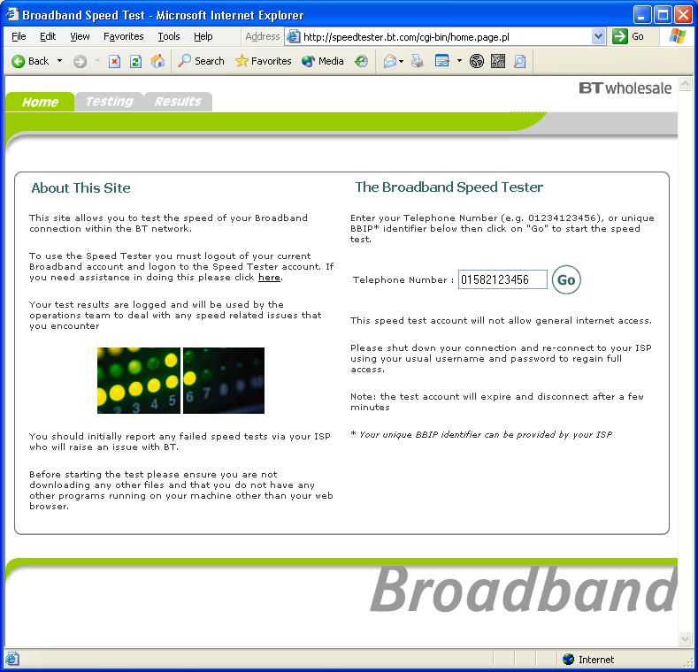

You should then see the following webpage displayed:
click on image for a larger view
Performing the speed test
Before the test can be run, you must enter your telephone number in the box provided. This is necessary so BT or your ISP can access the results of your test if you decide to report unacceptable line speeds. Once you have entered a valid telephone number, click the GO button to start the test.

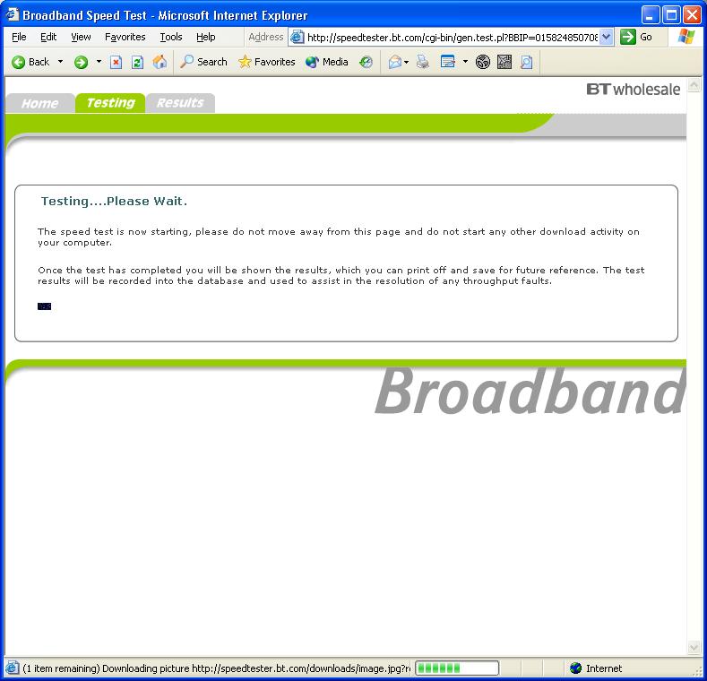

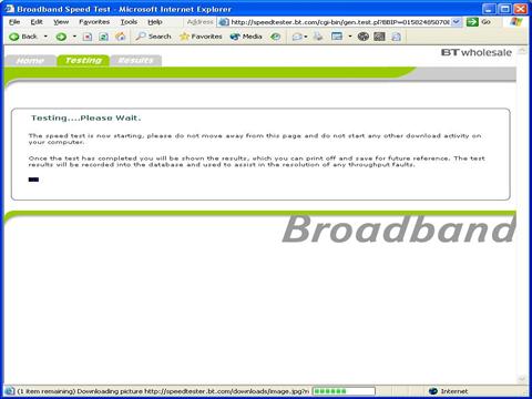

The test progress is shown in the progress bar at the bottom of your browser and also by a small black square beneath the webpage text, that gets bigger as the test proceeds. The example screen above shows the test just over half way through the download.

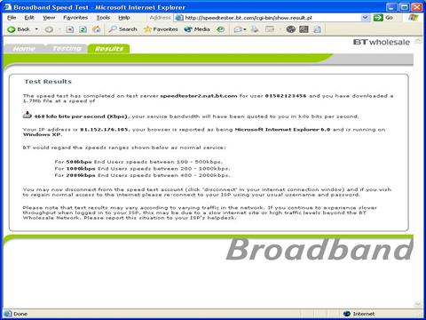

Once the test completes, a test results page is shown similar to the following:
There you will see your calculated download speed for your connection. Note: The IP address show is what BT has allocated and not the normal one you get from your ISP.
It is recommended that you repeat the test several times to give an average tested transfer speed. To repeat the test just click your browser's back button, which will take you back to the first page. Then just click the GO button again to repeat the test. Don't be surprised if the test results vary from test to test, this is not an accurate test as I explained at the beginning of this tutorial, but it will be more accurate than most due to it only using the BT network. You can try adjusting settings like MTU and RWIN, rebooting your PC and repeating the tests to see what settings are best for your set-up.
