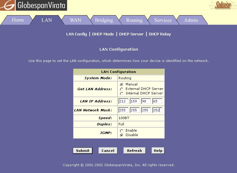

  1. Configure the router's LAN IP address to the second address in the block provided by PlusNet. Also set the subnet mask. Once this has been done go to the Admin tab, select the commit & reboot link then click the commit button.
    LAN Configuration screen. [Click it for a larger image.]

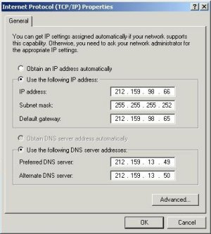

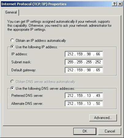

  2. On the Server PC, set the third IP address from your range as the PC/Server's IP address, and set the subnet mask as before. The default gateway should be set to the router's IP address.
    Windows PC TCP/IP Properties screen. [Click it for a larger image.]

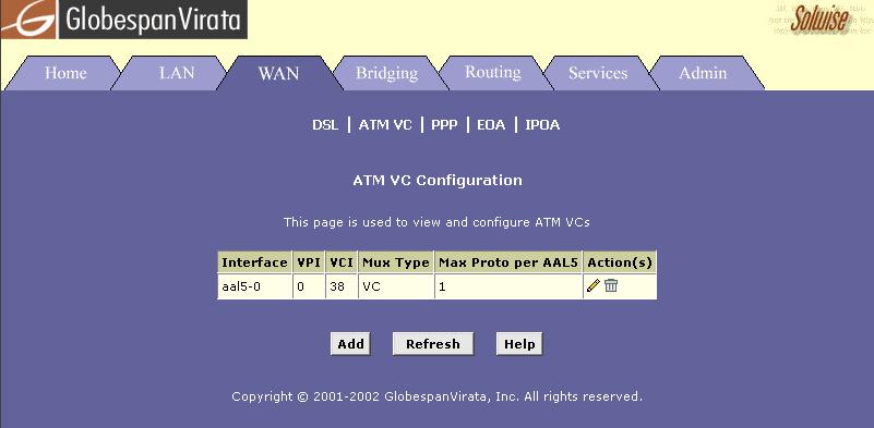

  5. Go back to the browser and access the router on the second IP address of the range eg http://212.159.98.65
    Set the ATM VC with the correct values VPI: 0, VCI: 38 and Mux type: VC.
    ATM VC Configuration screen. [Click it for a larger image.]

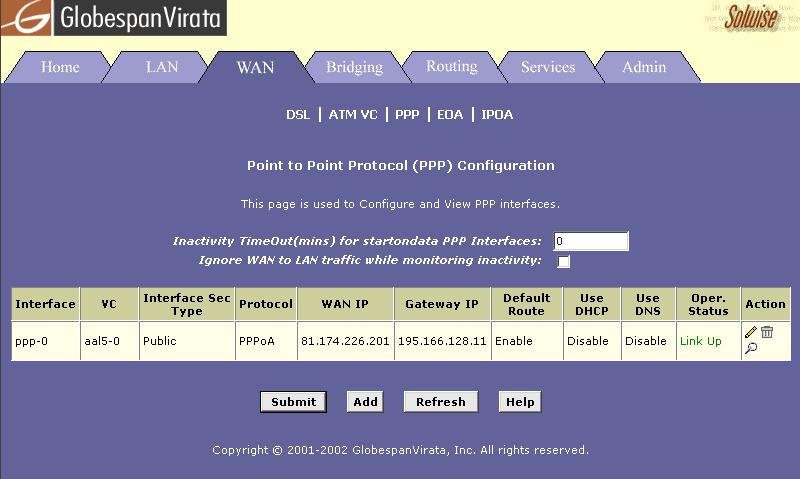

  6. Now set your username and password in the ppp settings. (Click on the pencil icon under Action to bring up the data entry screen.)
    PPP Configuration screen. [Click it for a larger image.]

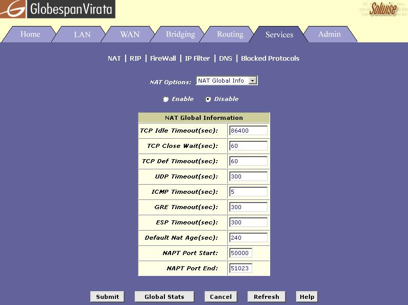

  7. Then disable NAT in the services menu.
    NAT Options screen. [Click it for a larger image.]
